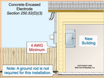

A. Changes to 250.50 were made to clarify that where any of the following electrodes “are present” they must be bonded together to create the grounding electrode system.
  • Underground metal water pipe [250.52(A)(1)]
  • Metal frame of the building or structure [250.52(A)(2)]
  • Concrete-encased foundation or footer steel [250.52(A)(3)]
  • Ground ring [250.52(A)(4)]
  • Ground rod [250.52(A)(5)]
  • Grounding plate [250.52(A)(6)]
The intent of the change to 250.50 (wording changed from “if available” to “are present”) and the addition of the exception was meant to require the use of concrete-encased foundation or footer steel as part of the building or structure grounding electrode system in new construction (if they are present), since they are considered “present” before they pour concrete.
For example, if a new building contains rebar in the footing or foundation, it must be used as a grounding electrode. This electrode would serve as the supplement water pipe electrode that is required by 250.53(D)(2).
Note: Ground rods will no longer be necessary for most new construction, since virtually all new construction uses concrete encased reinforcing bars or rods in the foundation. Since they exist, they must be bonded to and used as part of the grounding electrode system. (Figure above)
