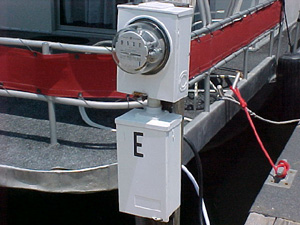

A preventable disaster. As more evidence was uncovered, the investigation into the deaths of the two women began to focus on the electrical system. On the day of the incident, the resort at which the boat was docked had put into service new power pedestals that required boat owners to use new shore power cords. The owner of the boat in question — and the husband and father of the two victims — had been working that morning on converting his existing Type SOW 600V power cord, which required nothing more than discarding the pig-tail adapter that had been used for the old service and plugging the cord into the new pedestal.
However, in making the conversion, he also altered the female plug connector at the boat. In doing so, he miswired the ground and hot wire, thus energizing the boat's aluminum hull, railing, and ladder. In addition, the wiring within the boat had been altered. Additional circuits had been added, and the incoming power had been changed from 125V (as designed) to 125/250V, which had exceeded the listed rating of the houseboat's female receptacle.
Without complete GFCI or isolation transformer protection, the safety grounding system had to be intact to protect the boat.
The underwater metal hull of every boat in a marina is electrically connected through the shore power grounding system while moored. So while most of these accidents occur when both the fault and missing ground are on the boat, as was the case in this incident, the marina operator must ensure that his dock power system is in good condition. Sec. 3.21 of the NFPA 303 Fire Protection Standard for Marinas and Boatyards describes a visual inspection and a ground integrity test the marina operator should be aware of. Many don't even know this document exists. Lawsuits initiated in response to electric shock drownings have involved the marina operator at least to some extent if they weren't making the proper effort to comply with existing standards. It goes without saying that ignoring NFPA recommended practices increases the marina's exposure to liability.
The NFPA 303 ground integrity test should be conducted under load. One major manufacturer's test instrument locks the circuit momentarily to 15A and displays the ground impedance. Dock personnel can then log the readings for later review by an electrician.
Since most of the problems that cause these drownings originate on the boat and many are generated by nonqualified workmanship, it may be necessary to implement around-the-clock monitoring of the marina shore power system to detect ground faults. Such a system is available and currently in use in nine marinas.
