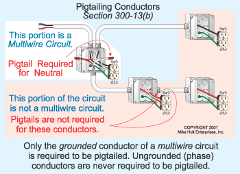

Q. Does the NEC require you to pigtail conductors from a 2-wire circuit if more than one wire terminates on a receptacle?
A. No, pigtailing is not required for 2-wire circuits. However, for multiwire branch circuits (3-wire or 4-wire circuits) where the removal of such devices would interrupt its continuity, the continuity of a grounded (neutral) conductor cannot be dependant on device connections [300.13(B)].
