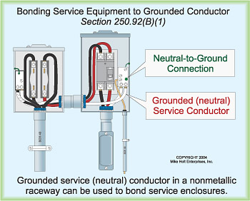

Q. I'm working on a job where a meter enclosure and a main breaker panel are connected by PVC and the neutral is bonded to the meter enclosure and the panel enclosure. The service conductors enter the meter enclosure through a hub with rigid metal conduit. Is any more bonding required for the service?
A. Additional bonding isn't required for this service. The metal riser is bonded to the meter enclosure by the threaded hub, provided the connection is made wrench-tight as required in 250.92(B)(2). The meter enclosure is bonded to the grounded (neutral) conductor because in this case the neutral terminal is bonded to the meter enclosure [250.92(B)(1)] (Figure at right). The service disconnect is bonded by the main bonding jumper that's located in the panel enclosure [250.28 and 250.92(B)(1)].
While the Code-required bonding has been provided (250.92), the service must be grounded to a suitable electrode in accordance with 250.24(A) and 250.50.
