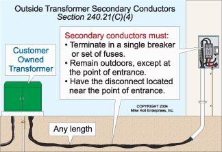

Q. Are there any restrictions on the length of outside conductor (without overcurrent protection) runs, at the point they receive their supply between the secondary of a customer-owned transformer and a panelboard?
A. Outside secondary conductors can be of unlimited length without overcurrent protection at the point they receive their supply if they are installed as follows [240.21(C)(4)] (Figure):
  • The conductors must be suitably protected from physical damage in a raceway or manner approved by the authority having jurisdiction (AHJ).
  • The conductors must terminate at a single circuit breaker or a single set of fuses that limit the load to the ampacity of the conductors.
  • The overcurrent device for the ungrounded conductors must be an integral part of a disconnecting means, or it must be located immediately adjacent thereto.
  • The disconnecting means must be located at a readily accessible location that complies with one of the following:
a. Outside of a building or structure.
b. Inside, nearest the point of entrance of the conductors.
c. Where installed in accordance with 230.6, nearest the point of entrance of the conductors.
