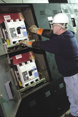

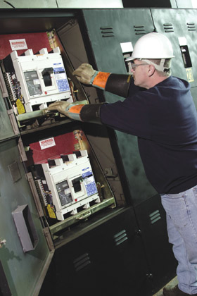

Generally speaking, a circuit breaker shouldn't be applied where the available short-circuit current at its line side terminals exceeds the circuit breaker's interrupting rating. This is a requirement of 110.9, which requires overcurrent protective devices to have an interrupting rating sufficient for the nominal circuit voltage and the available (short-circuit) current at the line terminals of the device.
Interrupting rating is defined as the highest current at rated voltage that a device is intended to interrupt under standard test conditions. Where fuses or circuit breakers that don't have adequate interrupting ratings are misapplied, they can rupture violently and damage equipment. In addition, such an event can pose health hazards to personnel, such as damage to eyesight and hearing, as well as burns from flammable clothing.
