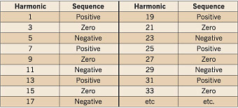

    Q. In some harmonic mitigation product literature, I've seen the terms “positive sequence,” “negative sequence,” and “zero sequence” used to refer to specific harmonic currents. What do these terms mean and why are they important?
    DeDad's answer: Positive sequence harmonic currents are the 1st, 7th, 13th, 19th, etc. harmonics. They consist of three phasors, each equal in magnitude but separated from each other by a 120° phase displacement. These harmonic currents have the same phase sequence as phasors that represent normal 60-Hz current.
    Negative sequence harmonic currents are the 5th, 11th, 17th, etc. harmonics. Like positive sequence harmonic currents, they consist of three phasors, each equal in magnitude but separated from each other by a 120° phase displacement. However, these phasors have a phase sequence opposite to phasors that represent normal 60-Hz current.
    Zero sequence harmonic currents are the 3rd, 9th, 15th, etc. harmonics. They consist of phasors equal in magnitude but with zero displacement from each other. Because these phasors are concurrent in direction, they produce an amplitude three times greater than any one phasor when they combine on the neutral of an electrical system. You'll also see these harmonics referred to as triplen harmonics. PCs, older versions of electronic ballasts, and phase-to-neutral nonlinear loads typically generate these harmonic currents (Table 1 at left).
