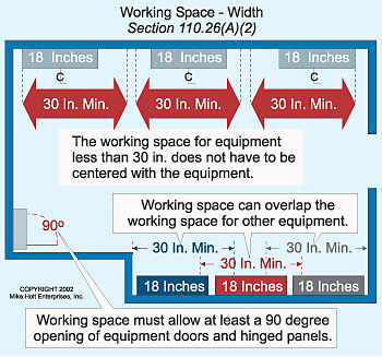

Q. How is the working space width requirement of 110.26(A)(2) measured? A. The working space must be a minimum of 30 inches wide, but in no case may it be less than the width of the equipment. The width of the working space is measured from left to right, right to left, or simply from the center line of the equipment. In all cases, the working space must be of sufficient width, depth, and height to
Q.
A. The working space must be a minimum of 30 inches wide, but in no case may it be less than the width of the equipment. The width of the working space is measured from left to right, right to left, or simply from the center line of the equipment. In all cases, the working space must be of sufficient width, depth, and height to permit at least a 90° opening of all equipment doors (Fig. 1).
