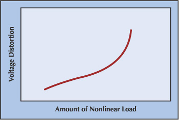

For the most part, voltage distortion increases with the number of nonlinear loads. However, as Fig. 1
Nonetheless, it's clear that more nonlinear loads lead to more distortion, and at increasing levels of voltage distortion, you should expect more problems with harmonics. Current estimates find that 25% of any given utility's load is now nonlinear, with more than 50% nonlinear load factor in office buildings and factories.
