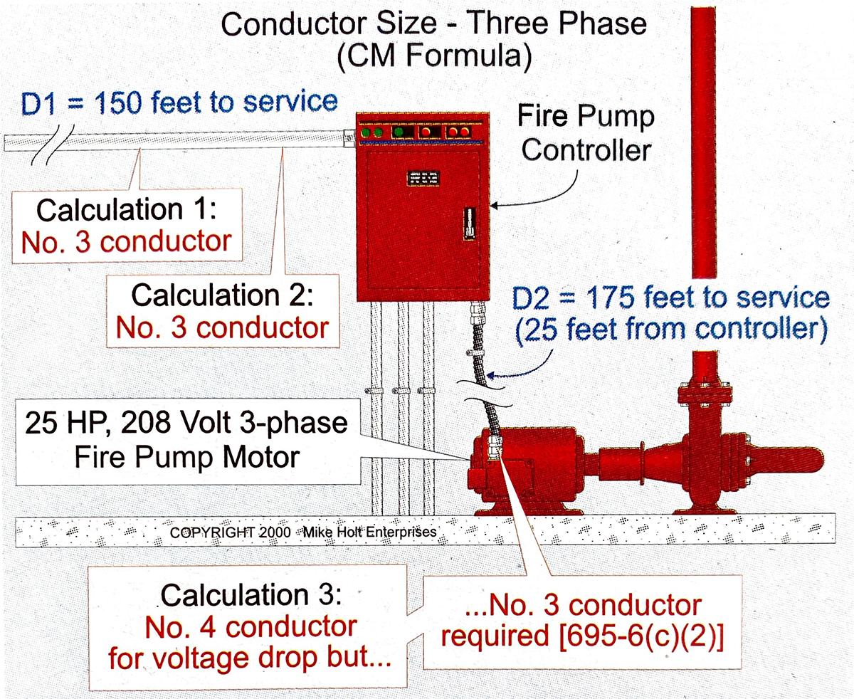

A 25 hp, 208V, 3-phase fire pump motor is 175 ft from the service. The fire pump motor controller is 150 ft from the service (the motor is 25 ft from the controller). What size conductor must you install to the fire pump motor? Assume the terminals are rated at 75°C (Fig. 2).
(a) No. 4 THHN
(b) No. 3 THHN
(c) No. 2 THHN
(d) No. 1 THHN
Answer: (b) No. 3 THHN
When sizing conductors for a fire pump motor, size the conductor to meet these requirements:
Calculation 1: Sec. 695-6(c)(2)
You must size branch-circuit conductors no less than 125% of the fire pump motor full-load current as listed in Table 430-148 or 430-150, based on a 75°C terminal rating [Sec. 110-14(c)(1)] as listed in Table 310-16.
74.8A x 1.25 = 93.4A,
No. 3 THHN at 75°C is rated 100A
Calculation 2: Sec. 695-7
Operating voltage at the motor controller terminals shall not drop more than 15% below the controller-rated voltage when the motor starts (lock-rotor current).
CM = (1.732 x K x I x D)/VD
CM = wire size (Chapter 9, Table 8)
K = 12.9 ohms, copper
I = 404A (locked-rotor, Table 430-151B)
D = 150 ft
VD = 31.2V (208V x 15%)
CM4(1.732 x 12.9 ohms x 404A x 150 ft)/31.2V
CM = 43,396, which calls for a No. 3 conductor per Chapter 9, Table 8.
Calculation 3: Sec. 695-7
The operating voltage at the terminals of the motor shall not drop more than 5% below the motor’s voltage rating while the motor operates at 115% of its full-load current rating.
I = 86A (74.8A x 115%), Table 430-150
D = 175 ft
VD = 10.4V (208V x 5%)
CM = (1.732 x 12.9 ohms x 86A x 175 ft)/10.4V
CM = 32,332, which calls for a No. 4 conductor per Chapter 9, Table 8.
Caution: For voltage drop, the No. 4 wire is okay from the controller to the motor, but Sec. 695-6(c)(2) requires the branch-circuit conductors to be no smaller than No. 3.
