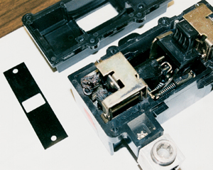

Electric parts most affected are those fabricated of bare copper, aluminum, and silver compounds (Photo 1). Many current-carrying parts are fabricated of copper or aluminum compounds. Silver is commonly used in electrical contacts found in circuit breakers and in plating of bus bars to provide good electric contact. Electronic components are especially susceptible to damage by corrosive atmospheres because they're small. Conformal coating generally used to protect printed circuit boards from dust doesn't protect against corrosive gases.
Photo 2 illustrates flaking of silver plating on bus bars. The areas in which flaking has occurred are no longer protected, which leads to further corrosion and poor connections. Such flakes can also fall from the bus bar and cause a short circuit or arc flash condition. In this case, the flaking was discovered after the electronic trip unit of a main circuit breaker was damaged by corrosion and tripped, causing an unexpected facility shutdown.
