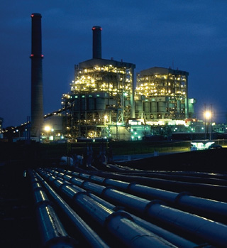

Central plant economics are hard to beat, but distributed generation (DG) is poised to enter the national scene. Within a few years, homes and businesses could become energy producers as well as consumers. Picture the power plant of the future. Do you see a hulking, smokestack-laden structure on the horizon converting large amounts of fuel into gigawatts of power to be sent over high-voltage transmission
Picture the power plant of the future. Do you see a hulking, smokestack-laden structure on the horizon converting large amounts of fuel into gigawatts of power to be sent over high-voltage transmission lines to thousands or millions of customers on an interconnected grid? If so, you may be overlooking a significant portion of the electric power industry of tomorrow. Many of the power plants of the future promise to be much smaller, much more local, and much more widely dispersed.
That, at least, is the promise of distributed generation (DG), a set of technologies that incorporate several different power generation techniques that share one common trait—the generation and distribution of electric power on a mini-grid serving a limited number of customers. Even more likely, future distributed generators will distribute power to a grid of one—a fuel cell powering one house, for instance, or a microturbine powering a single office building.
