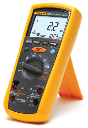

In addition to offering digital multimeter test features like AC/DC voltage, resistance, and continuity, the 1577 and 1587 insulation multimeters provide insulation resistance testing up to 600 Mohms and 2 Gohms, respectively. The 1577 offers 500V and 1,000V output voltages, and the 1587 provides output voltages ranging from 50V to 1,000V. A remote test probe enables one-handed insulation testing via a trigger on the probe handle. Capacitive voltage is automatically discharged from the equipment under test to prevent accidental shocks. Both meters carry 600V CAT IV and 1,000V CAT III ratings.
