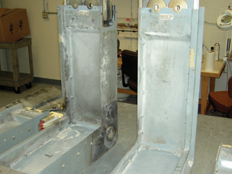

To provide continuous operation under all foreseeable circumstances, including utility outages and equipment breakdown, you must design reliability into an electrical system (Photo 1). Investigating the number of redundancies designed into the electrical system is one of the common analytical approaches. It identifies the normal source (N) and any redundant circuits/sources or equipment that would provide alternate paths for electrical power to flow.
