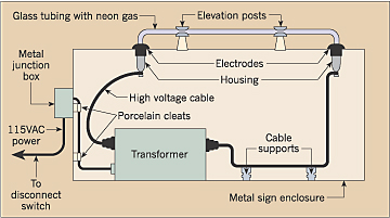

On the other hand, neon lighting can produce as many as 110 colors — including white — to blend or complement any color scheme. The life expectancies of neon tubes and their accompanying transformers are similar to those of cold cathode lighting systems (Fig. 1 at right). However, electronic transformers, which offer 50% energy savings and improved performance, are available as an alternative to standard coil-and-core magnetic transformer models. Though not as strong as cold cathode lamps, some neon lighting systems are capable of producing light output of 600 lumens per foot.
