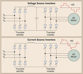

    Let's look at ASDs first. As shown in Fig. 1, the front end of an ASD is typically a diode rectifier, which converts an incoming AC voltage to a DC voltage. An inverter then converts the DC voltage to variable AC voltage with variable frequency. When the inverter uses an asynchronous switching scheme, it can produce harmonics in current. (According to the Wiley Publishers book Power Electronics: Converters, Applications, and Design, asynchronous switching occurs when the ratio of the switching frequency of the power electronic switches is an integer multiple of the fundamental frequency of the inverter voltage output.) If the harmonic current passes through the DC link and proceeds to propagate into the supply system, it's possible you'll have interharmonic problems.
