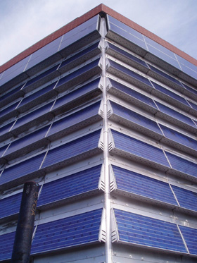

In New York City, solar panels soak up the sun's energy on the western façade of Solaire, the nation's first green residential tower. The 30-story, $100 million building features 33kW of photovoltaic systems, energy-efficient lighting, and energy-saving appliances. Two systems are located on the south and west wall of the buildings' mechanical bulkhead, and custom German-manufactured solar panels are integrated into the building's glass curtain wall and clear glass entrance canopy.
“It's a high-profile building in the solar world,” says Anthony Pereira, president of Altpower, Inc., a New York City-based design/build specialty-contracting firm that focuses on renewable energy systems for urban areas. “Solar is not the cheapest product per square foot, so if you're going to put it on a building, why not have it work as your building's façade to bring down the cost?”
Solaire's photovoltaic system meets Battery Park City Authority's green building guidelines, which mandate that every new building built in Battery Park City must have at least 5% of its base building load served by renewable energy systems. Solaire is 30% more efficient than any other building constructed in Manhattan to date, Pereira says. During the construction project, the team had to purchase as many materials as possible from within a 500-mile radius of the jobsite, recycle building materials, and use paints and finishes with low volatile organic compounds. The contractors even installed photovoltaic panels on their jobsite trailers to save energy during the construction process.
The New York State Energy Research and Development Authority provided funding for the project, which began in June 2001 and was completed in December 2003. Solaire became the first building constructed in lower Manhattan since 9/11. Altpower is now working on several other renewable energy projects, including the design and construction of a zero energy skyscraper that will produce as much energy as it consumes. Slated to be the second tallest building in New York City, the structure will feature such distributed generation technologies as wind turbines, photovoltaics, and microturbines.
