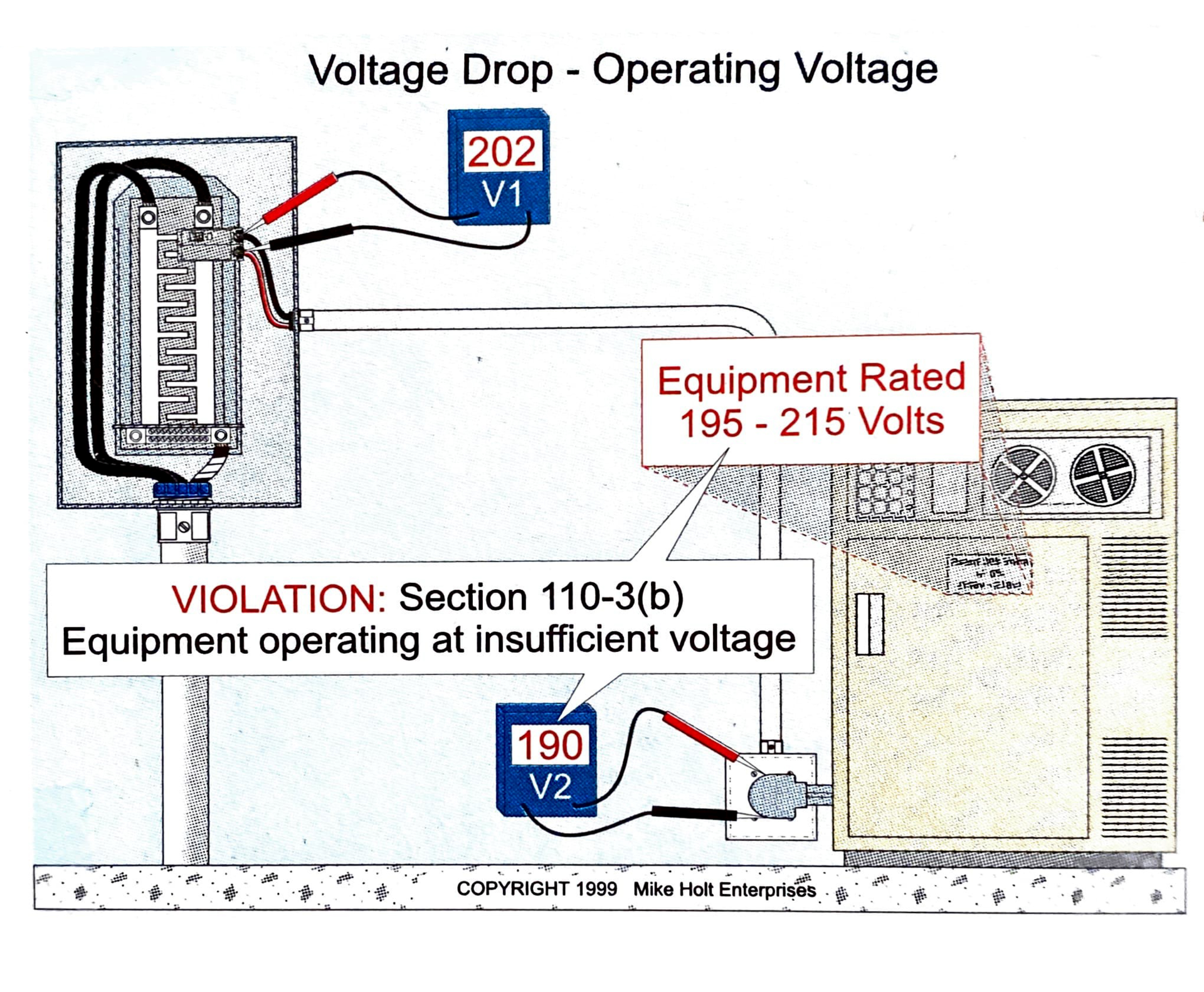

FPNs in the NEC are for informational purposes only. They're not enforceable by the inspection authority [90-5(c)]. However, Sec. 110-3(b) requires you to install equipment in accordance with the equipment instructions. Therefore, you must install electrical equipment so it operates within its voltage rating as specified by the manufacturer. (Fig. 1)
Due to voltage drop within the circuit conductors, the operating voltage at the electrical equipment will be less than the output voltage of the power supply. Inductive loads (such as motors or ballasts) operating at a voltage below their rating can overheat. Under-voltage for any sensitive electronic equipment (such as copy machines or computers) could cause equipment to power down or lock up. This can mean data loss, increased cost, and even possible equipment failure. Resistive loads (such as heaters or incandescent lighting) that operate at under-voltages will not provide the expected rated power output.
