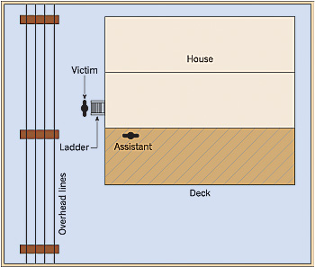

Before the accident, the contractor had been working his way around the house, using a 22-foot extension ladder to reach the gutter. It was at the northwest corner of the house, where the utility service drop for the house was located, that the accident took place (Fig. 1).
When he reached this corner, he would have had to climb down the ladder to move it around the service drop. Before he moved it, the top of the ladder was just lower than the service drop but around the corner. The assistant later stated that he glanced over and saw the top of the ladder slowly move away from the house and around the corner. He suspected that the contractor didn't collapse the ladder prior to moving it because he wanted to speed the job along. But shortly after the assistant went back to his work, he heard the noise and turned to find that the top of the ladder was nowhere to be seen.

The assistant's description brought into question what exactly happened. Did the handyman make contact with the utility distribution feeder connected to the service drop or did he bring his ladder into contact with the service drop conductors? With only one witness who had a limited view, it was difficult to answer this question at first, but a thorough recreation of the events revealed that the cause of the accident was as simple as the steps that could have been taken to prevent it.
The facts behind the accident. Our investigation exposed several items of note. First, the corner of the house where the accident took place is located at a high point on the grass-surfaced yard. The surface angles downward from that corner of the house at a 5° slope. The service drop was located on the west side of the house, which was in the shade for most of the morning. As a result, it's likely that the grassy surface was damp with morning dew. Making matters worse, the event took place on a clear sunny day, and sundial calculations revealed that at the time of the accident the sunlight was almost directly parallel to the angle of the ladder against the house. This would have placed the sunlight in the handyman's eyes at the moment he was attempting to move the ladder around the corner of the house.
The 22.8kV 3-phase utility distribution feeder was located about 15 feet from the corner of the house. The conductors were 16 feet above the ground, which placed them in direct line with the height of the service drop. This measurement was estimated based on a comparable height measurement taken off of the raised wooden deck at the rear of the house. The height of the wires met National Electrical Safety Code (NESC) regulations, Table 232-1, which states that the vertical clearance from a “way subject to pedestrians” should be a minimum of 14.3 feet above the ground.
Based on the angle of the grassy surface and the height of the house's northwest corner, we estimated that the contractor would have had to extend the aluminum ladder about 18 to 20 feet to reach the upper corner of the house.
Because the contractor didn't collapse his ladder as he came around the corner, he was putting himself in danger of making contact with the overhead lines. He would have had to lift it up and balance it as he was moving around the corner, and its center of gravity would have been raised, causing it to become unstable and requiring more effort to maintain control. Based on information provided by the assistant, the contractor was about 6 feet tall. After lifting the ladder, he would have added about 2 feet to its extended height. This would most likely place the top of the ladder at approximately 20 to 22 feet off of the ground — about 2 feet above the service drop and well within range of the feeder conductors.
The environment would have also played a part in the unfortunate accident. As he was rounding the corner of the house, the sunlight would have hit him in the eyes, and he most likely lost his concentration for an instant. In addition, the ground had to have been slightly wet from the morning dew because the house was still blocking the grassy surface. These factors could have contributed to a minor struggle to maintain control of the ladder.
We determined that the combination of the sunlight, an imbalanced ladder, and the sloped wet ground more than likely caused him to lose his balance, slant the ladder back toward the distribution feeder conductors, and make contact with them (Fig. 2). The electrical energy would have passed through the ladder, through his body and into the ground, throwing him violently in some direction. The angle of his body indicated he was probably thrown away from the house and landed on his back.
