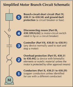

Fig. 1 (right) shows the elements of a typical motor load circuit. You can use one of the new devices as a:
  • Standalone controller
  • Standalone disconnect switch
  • Combination controller and disconnect switch
  • Combination controller and overload protection
UL 508 also permits manufacturers to combine three features—the disconnect switch, the motor controller, and the overload protection functions—into the device. While the NEC changes permit the 2-way combinations mentioned above, it is silent on the 3-way approach. You should verify this point with your local NEC inspector.
