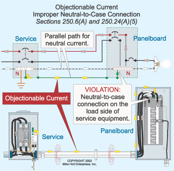

Common improper neutral-to-case connections. The most common improper neutral-to-case bonds occur in panelboards, separate building disconnects, transformers, and generators. Neutral current will flow on metal underground water piping systems where the water service to the building is metallic. However, this occurs only if the underground water pipe system is metallic and connected to other buildings. Although this isn’t an NEC violation, you need to be aware of such situations.
Panelboards. Bonding of the neutral terminal to the case of a panelboard, which isn’t part of service equipment or separately derived systems, creates a parallel path for return neutral current. The result is neutral current (net current) flowing on the metal parts of electrical equipment and on the grounding and bonding conductors (see Fig., right).

Transformers. If a neutral-to-case bond is made at both the transformer and at the secondary panelboard, neutral current will flow through metal raceways (and on the grounding and bonding path) on its return to the power supply.
