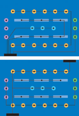

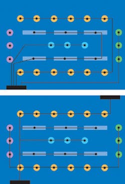

When configuring a fluorescent dimming system, the designer must specify control zones — that is, a fixture or group of fixtures that are controlled simultaneously by a single controller. For example, in a daylight-harvesting scenario with windows (Photo), the designer may place lighting circuits parallel to the window, and set up each circuit as a separate control zone. The smaller the control zones, the more granularity, or flexibility, you can achieve, along with higher energy savings. However, installation cost also increases.
Digital lighting control provides complete flexibility. When using analog dimming systems, the smallest zone is often a branch circuit. With a digital system, zoning is implemented using software, independent of circuits, using individual ballast addresses stored. Because each ballast is individually addressable, control zones can be established that are as small as a single ballast or light fixture. Ballasts or fixtures can also be grouped to provide up to 16 layers of controls/scenes, enabling highly granular and responsive control, the ability to generate a wide variety of zones and scenes in any controlled space, and the power to adapt to changes over time — even be completely reconfigured without rewiring. For large installations, you can network individual buses for the control of hundreds or even thousands of ballasts.

Simplified wiring
A single pair of control wires, which forms the bus, connect the ballasts and controls directly (Fig. 3), which simplifies wiring in spaces with multiple control zones by reducing the number of homeruns. The level of skilled labor is reduced because there is no need to pull wire according to a zoning schedule. Each ballast on the circuit is wired the same. There are no switch legs or three-way travelers. In addition, dimming control panels/modules are not needed to control light output. Instead, digital systems use a small power supply connected to the bus.
