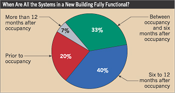

The majority of institutional facilities' building systems aren't fully functional before occupancy, according to a study by SCO Engineering, a Fort Wayne, Ind.-based consulting engineering and surveying firm. About 80% of the firm's 2003 Project Completion Survey respondents reported that systems work wasn't completed before the move-in date. By verifying the commissioning process at the end of a
The majority of institutional facilities' building systems aren't fully functional before occupancy, according to a study by SCO Engineering, a Fort Wayne, Ind.-based consulting engineering and surveying firm. About 80% of the firm's 2003 Project Completion Survey respondents reported that systems work wasn't completed before the move-in date. By verifying the commissioning process at the end of a project, planning ahead, and hiring a commissioning agent, firms can prevent this problem from occurring, according to the report. Firms involved with the design of correctional and K-12 facilities identified the following issues with commissioning:
