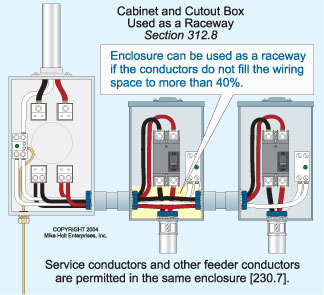

Q. Can I pass conductors from one panel through another panel? If so, what are the restrictions?
A. Yes, cabinets, cutout boxes, and meter socket enclosures can be used as a raceway for conductors that feed through if the conductors do not fill the wiring space at any cross section to more than 40% [312.8], as shown in the Figure.
Service conductors and other conductors are permitted to be installed in the same enclosure [230.7]. Splices and taps can be installed in cabinets, cutout boxes, or meter socket enclosures if the splices or taps do not fill the wiring space at any cross section to more than 75% [312.8].
