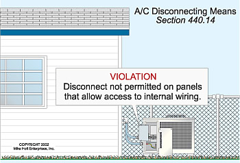

Disconnecting means. Art. 440 requires you to locate the disconnecting means within sight of, and readily accessible from, the air conditioning or refrigerating equipment. “Within sight” means visible from and not more than 50 feet from each other [Art. 100]. You can install the disconnecting means on or within the air conditioning or refrigerating equipment—but not on the access panels (Fig. 1).
This requirement has two exceptions:
  • You can lock the switch open if the equipment is essential to an industrial process and the installation meets certain requirements.
  • Where a plug and receptacle serve as the disconnecting means, they must be accessible. But they need not be readily accessible.
