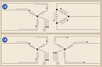

Q. I've heard and read that a distribution system's responses to harmonics generated by 120V loads like PCs and older-style electronic ballasts are different than those for harmonics generated by phase-to-phase connected loads like variable speed drives. Does the configuration of the distribution or service transformer have any effect on this?
DeDad's answer: The problematic harmonics are the 3rd, 9th, 15th, etc., which are called triplen harmonics. Phase-to-neutral nonlinear loads having switch-mode power supplies generate them. These power supplies draw current only at the peak of the voltage sine wave.
Basically, triplen harmonics are problematic for grounded-wye systems with current flowing on the neutral conductor because these harmonic currents are additive on the neutral conductor and can cause that conductor to overheat, a potential fire hazard.
Transformers can also be affected, depending on their winding configuration. Fig. 1a above shows a typical, non k-rated, delta-wye transformer, the most common type used in utility distribution substations (delta winding connected to transmission) and in 480V-120/208V, 3-phase, 4-wire distribution transformers in office buildings. The triplen harmonic currents enter the secondary (wye) winding from the nonlinear load. Since these harmonic currents are in phase, they add on the neutral. The primary (delta) winding actually provides ampere-turn balance, which allows the triplen harmonic currents to flow. However, these currents remain trapped in that winding while not showing up in the line currents on the primary side of the transformer. The higher the content of triplen harmonic currents in the delta winding, the greater the amount of transformer overheating.
Using a grounded wye-wye transformer, as shown in Fig. 1b, will allow the triplen harmonic currents to flow through both the secondary and primary windings unimpeded. However, you must be careful here. If you remove the neutral connection on one or both windings, you will be blocking the flow of triplen harmonic currents. Because 3-legged core transformers operate or behave as if they have what may be called a “phantom” delta tertiary winding, a wye-wye connected transformer with only one neutral point grounded will still conduct the triplen harmonic currents from the grounded side.
Finally, the above discussion of triplen harmonic current flow really applies only to balanced loading conditions. When this isn't the case, you may find triplen harmonic currents flowing where you least expect them. And, they may have positive or negative sequence components as well.
