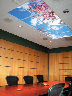

Most people probably don't consider a six-month dental checkup particularly inspirational, but for Bill Witherspoon, a trip to the dentist's chair prompted the development of a unique lighting technology called SkyCeilings. Produced by Witherspoon's company, the Sky Factory, Fairfield, Iowa, SkyCeilings are photographic images of real skies that fit into standard drop-ceiling grid systems and feature the company's own light box to illuminate the translucent images from behind.
“I think almost everyone has had the experience of lying in a confined space, such as a hospital bed or the dentist's chair, and counting specks on the ceiling,” says Skye Witherspoon, Bill's son and product developer for the Sky Factory. “Situations like these are what spurred this product's invention.”
The system is comprised of three parts: Luminous SkyTiles, SkyTile Elevators, and fluorescent or LED lamps. The tiles are high-resolution photographic images on translucent acrylic or polycarbonate panels that the company says meet or exceed all national and international fire-safety codes. The elevators, which are square or rectangular aluminum frames that snap into the T-bar cells of a ceiling grid system, raise the tile 1¼ inches above the ceiling grid to create a 3D support structure that mimics a real skylight.
“I think that when people see our product it's always a big surprise,” notes Skye Witherspoon. “A lot of people are fooled by the illusion of nature we create. People have entered a building that has a SkyCeiling, looked up, and been dumbfounded. They said, ‘I was just outside a few minutes ago, and it was cloudy. What's going on?’”
According to the company, SkyCeilings fit into standard 2-ft × 2-ft, 2-ft × 4-ft, 60-cm × 60-cm, or custom grid systems. Although a rectilinear shape is the most common, other choices include circular and elliptical. Available in thousands of images, the product uses either 6,500-Kelvin daylight-balanced T5 fluorescent lamps or 6,500-Kelvin daylight-balanced LEDs. All T5 fluorescent systems can be fitted with an optional dimming system that can include manual, remote, or programmed switching. Furthermore, a digitally addressable lighting interface (DALI) can be programmed to produce a range of lighting effects, including the ability to program the product at any latitude and longitude to follow the rising and setting of the sun as well as track the seasons. Applications for this feature include hospital ICUs where it is important to reinforce or re-establish circadian rhythms to promote healing. In nurse's stations, casinos, and other 24-hour environments where a high level of alertness is needed, the process can be reversed — triggering the affect of midday in the middle of the night.
