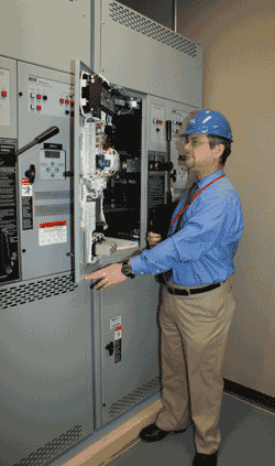

    The project included redesigning the facility-side feed from the electric utility source, which comprises a single substation, roadside utility vault, and utility transformer. A new, pad-mounted 2,500kVA transformer also was installed. Inside the building, electric utility power feeds a switchboard that distributes power to two main closed transition ASCO transfer switches through separate breakers, each of which supplies power to the “normal” side of one transfer switch. These transfer switches establish a dual bus power feed arrangement to provide reliable, redundant power to the data center.
    A 1,250kVA / 1,000kW generator feeds a switchboard that also distributes power to the two main transfer switches. The distribution switchboards keep power flowing through the uninterruptible power supplies to 75 server racks that manage information for national and international customers. Power also is supplied to four command center office units: a “War Room,” print room, build room, and the data center command and control room.
    A 230A secondary ASCO transfer switch directs power from both busses to lighting panels and generator-backed receptacles. In addition, each computer room air conditioner unit is powered by a dedicated transfer switch supplied from both of the dual bus power feeds.
