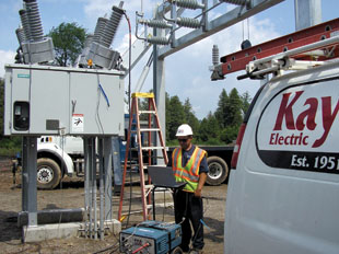

At first glance, Kay-R Electric, Syracuse, N.Y., seems like a typical electrical contracting firm. The company specializes in electrical construction and service for the power, manufacturing, commercial, health care, and education markets. What sets Kay-R apart from most of its electrical contracting counterparts, however, is that the company also runs a high-voltage testing and maintenance division.
Staffed by 15 employees, consisting of dedicated engineers, project managers, safety managers, testing technicians, and equipment and vehicle maintenance staff, the high-voltage testing and maintenance division coordinates projects with the company's construction department. Currently, Kay-R is working on two wind farm projects — one that will support 112 wind turbines and another that will support 23 — where the construction division will deliver the utility-grade, high-voltage substations through the design/build process, while the high-voltage testing and maintenance division will manage all the testing required on the project.
Launched in 2004, Kay-R's high-voltage testing division realized a revenue gain of $450,000 in sales at the end of its first year to more than $1.2 million in 2006. To limit financial risk and help offset the significant investment it took to start the division — higher tooling costs and insurance premiums due to the dangerous nature of high-voltage testing work — Kay-R set up a separate company, what's referred to as a “captive equipment asset holding company,” which purchased all of the testing and maintenance equipment from manufacturers and now leases it exclusively to Kay-R.
“We basically started from ground zero,” says Phil O'Connor, one of the majority owners and COO of Kay-R. However, “ground zero,” is an understatement. Although Kay-R was essentially starting a new business, it could leverage its construction customer base into maintenance customers. In the testing and maintenance sector, repeat business is key. “To secure work in the industry, you really have to have a track record to develop any backlog in the industry,” O'Connor says.
