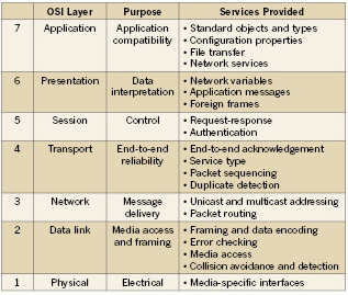

The LonTalk protocol embraces all seven layers of the OSI model and handles tasks such as media access and transaction acknowledgment, along with more advanced services such as sender authentication, priority transmission, duplicate message detection, and recovery. The features of the seven-layer protocol in LonTalk are summarized in the Table above.
At the Data Link level of the OSI model (media access and framing), the LonTalk protocol uses a proprietary collision prediction algorithm called predictive p-persistent CSMA (collision sensing multiple access), which permits a channel to carry its maximum capacity, rather than having its throughput degrade due to excess collisions. Collisions that reduce throughput can occur with some versions of the Ethernet protocol, which also uses the CSMA procedure. At the fastest data rate of 1.25 Mbps, using twisted-pair, the LonTalk protocol supports more than 500 transactions per second, in the case of a 12-byte message length.
