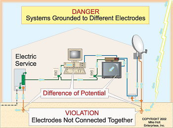

An SPD won't function properly unless the system is grounded according to Art. 250. Many often forget to reduce the difference in ground reference between port connections for multi-port appliances. You must ground all communications systems to the same grounding electrode system as the power. It's an NEC violation to provide separate grounds for the power system and communications system — doing so is just inviting a flashover from one system to the other.
