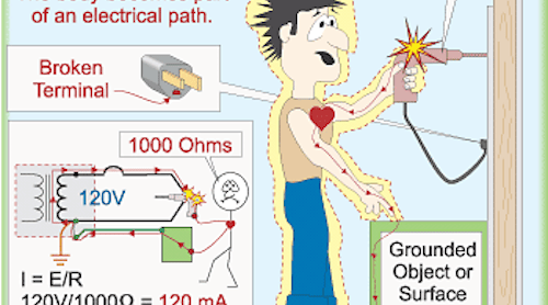

The severity of electric shock depends on the current flowing through the body, which is a function of the electromotive force (E) in volts, and the contact resistance (R) in ohms. Plug these values into the formula I=E÷R to find out how much current will flow through the body.

According to IEEE Std. 80, you can determine the maximum safe shock duration by the formula, T=0.116÷(E÷R), where T is duration in seconds, E is the electromotive force in volts, and R is resistance of the person, which is a constant 1,000 ohms (see Figure).
For a 120V circuit, maximum shock duration=0.116÷(120V÷1,000)=1 sec
