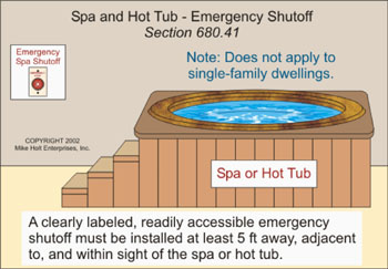

    In other than a “single-family dwelling,” a clearly labeled emergency spa or hot tub water recirculation and jet system shutoff must be provided. It must be readily accessible to the users and located not less than 5 feet away, but adjacent to and within sight of the spa or hot tub (680.41) (Figure at right).
    The emergency shutoff is meant to protect users. Deaths and injuries have occurred in less than 3 feet of water when individuals became stuck to the water intake opening. This requirement applies to spas and hot tubs installed indoors as well as outdoors.
