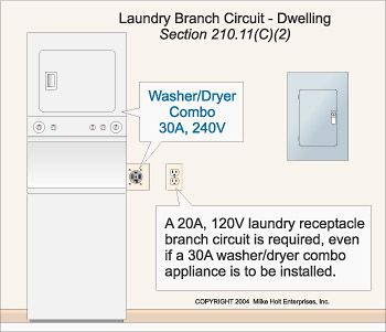

Q. We recently bid a project that involved a stackable washer/dryer in each dwelling unit of an apartment building supplied by a single 30A, 240V receptacle circuit. The inspector says we must install a 20A, 120V laundry receptacle circuit in addition to the 30A, 240V receptacle circuit. This makes no sense to me. A. The Code doesn't provide for an exemption to the rule in 210.11(C)(2) and 210.52(F)
A. The Code doesn't provide for an exemption to the rule in 210.11(C)(2) and 210.52(F) that requires a receptacle outlet served by a 20A branch circuit to be provided in the laundry area of a dwelling unit. This circuit would be in addition to the 30A branch circuit required for the combination washer/dryer (Figure).
