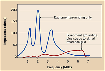

Q. We have a signal reference grid beneath the raised floor of our IT equipment room. I realize that this grounding system has impedance at 60 Hz that is low enough to equalize any potential differences. This keeps all metallic enclosures, raceways, and any other grounded metal at the same ground potential. But what about higher frequencies? If I remember my basic electrical theory correctly, I will not be able to get this equalization because of the increased impedance associated with these frequencies.
DeDad's answer: Your memory of basic electrical theory is correct, but your signal reference grid (SRG) will be able to handle higher frequencies if it's installed correctly and uses the right type of bonding straps and conductors.
The impedance of a conductor has three basic components: resistance, capacitive reactance, and inductive reactance. Although the inductance (L), in Henrys, will be constant for a given length and cross sectional area of a conductor, the inductive reactance (XL) will vary with the frequency (f) of the applied voltage, according to the equation XL = 2µfL.
So at 60 Hz, XL = 2 × 3.14 × 60L, or 377L. At 30 MHz, XL = 2 × 3.14 × (30 × 106)L, or 188.5 × 106L, or 188,500,000L. By dividing the value of inductive reactance at 30 MHz by that at 60 Hz, you'll find that the “equivalent” resistive value of a given conductor, at 30 MHz, is about 500,000 times greater than the same conductor when the applied voltage is at 60 Hz.
In addition to increased inductive reactance at higher frequencies, there is stray capacitance and inductance between adjacent conductors or between conductors and adjacent grounded metal. There are also some resonance effects. All of the above will also contribute to an increase of apparent conductor impedance.
If you connect the conductors in a mesh or grid to form a lot of low-impedance loops in parallel, you should see little voltage difference between any two points in the grid from 60 Hz up to a frequency where the length of one side of the square represents about 1/10 wavelength. For example, a grid made up of 2-ft squares will provide, at any point, an effective equipotential ground reference point for signals greater than 30 MHz. The Figure above offers a graphic description of impedance vs. frequency plots for equipment grounding only and equipment grounding plus straps to an SRG.
A note of caution: Make sure you're using the shortest possible lead length for bonding jumpers to connect your IT equipment frames to the SRG. Also, make sure you're using braided bonding straps for these connections and 7-strand No. 6 bare copper bonding jumpers to tie under-floor metal components with steel building columns. Finally, verify that every sixth metallic raised floor pedestal is bonded to your SRG.
