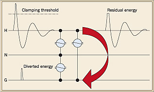

The event commonly called a surge is more accurately defined as a high-voltage transient or impulse. Surge strips are designed to divert the impulse away from the sensitive electronic system. That's why the term diverter is more appropriate for this type of protective device.
Plug-in surge strips commonly use one or more of several electronic components, which may include metal oxide varistors (MOVs), silicon avalanche diodes (SADs), and gas tubes. There are differences in how each functions, but the intent is the same (Fig. 1) — to divert a part of the harmful impulse energy away from the computer or system being protected.
All surge strips have a voltage threshold, called a “clamping voltage,” at which they begin to conduct. Above that threshold, impulse energy is shunted across the diverter to another pathway — typically the safety ground. When the impulse voltage once again falls below the threshold, the surge strip stops conducting. Surge strips also have a “clamping response” time, which is the time required for the device to respond to an impulse. The amount of energy that a surge strip is capable of handling without being destroyed is also a consideration.

Surge strips function by diverting disturbance energy to ground as we saw in Fig. 1. In the process, they convert a destructive disturbance into a disruptive one. Meanwhile, because the surge strip allows substantial energy to pass on to the computer, the computer itself may still be degraded by the residual surge energy. This explains why in so many instances a user experiencing catastrophic hardware failure will install a surge strip only to find that hardware failures (while fewer) still occur — and that the system now behaves unreliably at times.
