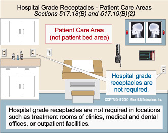

Q. Where are hospital-grade receptacles required?
A. Receptacles for inpatient sleeping beds or procedure table beds used in a critical patient care area (patient bed location) must be listed as “hospital grade” [517.18(B)].
They aren't required in treatment rooms of clinics, medical and dental offices, or outpatient facilities because these facilities don't have a “patient bed location” as defined in 517.2 (Figure at right).
