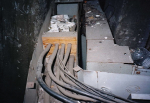

    Wireway covers missing
    A recent electrical inspection uncovered this section of metal wireway in the attic of a tall building. Not only was the wireway missing its covers, but someone had also used the area as a trash receptacle. This would undoubtedly add to the fuel load in this space if a fire were to break out nearby. In addition, the blocks used to support the conductors weren't a recognized method of installation. Sec. 376.2 defines a metal wireway as a sheet metal trough with a hinged or removable cover used to house and protect electric cables that are laid in place after the wireway has been installed as a complete system. Installing wireways as a complete system will ensure that they're properly grounded [250.118(14)].
