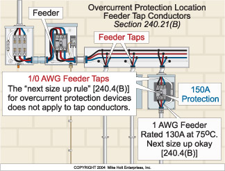

Q. I want to come into a power distribution block with one feeder fused at 400A and feed three 150A panels. How do I size the tap conductors for each panel if they don't exceed 10 feet in length?
A. The tap conductors must be sized not smaller than the calculated load in accordance with Art. 220 — and not smaller than the rating of the overcurrent protective device at the termination of the tap conductors. Also, the tap conductors must have an ampacity not less than 10% of the ampacity of the overcurrent protection device that protects the feeder [240.21(B)(1)].
Example: What size tap conductor would be required from a 400A overcurrent protection device supplying a 150A circuit breaker if the calculated continuous load was 100A?
1/0 AWG tap conductors would be required to supply the circuit breaker. A 1/0 AWG “feeder” can be protected by a 150A overcurrent protection device because of the “next-size-up” rule [240.4(B)]. However, this rule does not apply to feeder “taps” (see Figure).
