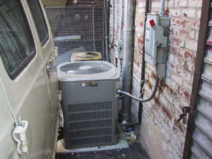

Unguarded Equipment
Aside from having the wrong makeshift cover on the disconnecting means, this equipment isn't protected from damage. This violates 110.27(B) of the 2002 NEC, which states that “locations where electric equipment is likely to be exposed to physical damage, enclosures or guards shall be so arranged and of such strength as to prevent such damage.” The use of a concrete-filled RMC often serves as a guard in similar installations. The cover used on the receptacle could also be cited, because it doesn't meet the current requirement in 406.8(B).A Winding Conduit Path
