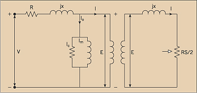

MCA allows the analyst to view the simple resistance, complex resistance, inductance, phase angle, ground insulation condition, and other tests to determine the condition of the electric motor windings. For reasons of safety and accuracy, these readings are best obtained with the equipment de-energized.
In principle, an electric motor circuit is a series of simple and complex resistance, inductance, and resulting phase angles that are each 120° apart in a 3-phase system (Fig. 1 above). When original defects or impending failure degrade the 3-phase winding, these phase angles become unbalanced. In an assembled electric motor, casting voids or broken bars in the rotor, poor air gap, or a bowed shaft and the resultant mutual induction between the stator and rotor will cause variations.
The ability of MCA equipment to read the mutual inductance between the stator and rotor also allows the analyst to detect defects within the rotor or air gap effectively, quickly, and safely. Most MCA equipment can operate on motors from fractional to more than 10,000 hp and 12V to more than 13.8kV, giving them a broad range of operation. However, this equipment shouldn't be confused with RCL meters, which only provide resistance, capacitance, and induction readings — usually with a Megger or polarization index test added. High-quality MCA units are available for less than $10,000, including software.
An important difference between RCL and MCA meters is their respective impedance readings. Voltage and current unbalances are inversely proportional in AC applications. This provides an important distinction, as a great deal of work has been completed on the economic effects of voltage unbalance. Using simple resistance, you can determine the I2R loss across a point, but you won't be able to determine system reliability. This is also the case with inductance, which varies depending on the winding design and rotor-to-winding position. Systems that use inductance as a base will often fail good electric motors and windings. To obtain a true condition of a motor winding, you must view all of the motor circuit components, including resistance, impedance, inductance, phase angle, and insulation resistance.
