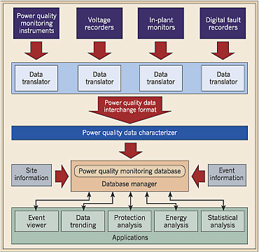

Your data analysis system must be flexible enough to handle data from a variety of monitoring equipment as well as maintain a database you can use for many different applications (Fig. 1 above).
Different types of power quality variations require different types of analysis to characterize system performance. And with a flexible system, you can customize these applications to individual user needs.
