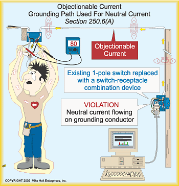

  • When the bonding path serves as a neutral conductor, which happens when a 125V receptacle is installed at a switch location where a grounded (neutral) conductor is unavailable, and the equipment grounding conductor is used as the neutral.
Objectionable current on grounding and bonding paths can raise the temperature at a loose fitting enough to ignite combustible materials. Arcing at loose fittings is very dangerous in areas that contain ignitable and explosive gases, vapors, or dust.
This current can also result in dangerous voltage on metal parts of electrical equipment. The possibility of death from ventricular fibrillation exists any time the voltage is more than 30V.
