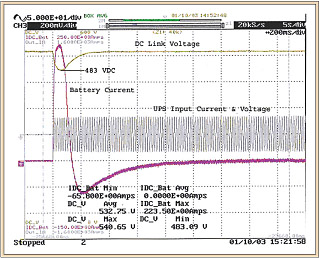

Short step loads occur frequently in many commercial and industrial applications, often with no indication that the batteries are being cycled. Such a step load is shown in Fig. 1 on page 34. In this case, the UPS batteries alone provide ride-through.
Fig. 2 at right shows this same 150kW step load on the same UPS but with the FESS in parallel with the UPS batteries. Once the load is applied, both the battery and FESS respond to the demand and provide energy to the UPS. However, the FESS continues to provide energy as the battery current drops back to zero. Note that the DC link voltage only drops to a minimum of 521VDC. Because this voltage level exceeds the open-circuit voltage of the battery, the battery doesn't experience a chemical discharge. The energy delivered only comes from the static charge on the plates. The FESS continues to provide power at a constant voltage while delivering the current to meet the demands of the UPS.
Input power interruptions. Because most power outages last less than a few seconds, the ability of an FESS to shield the battery from short discharges can significantly improve battery life. Fig. 3 at right and Fig. 4 on page 38 illustrate how flywheels accomplish this. Fig. 3 shows a power outage with the same 150kW load applied to the same 300kVA UPS with the same string of batteries, but without a flywheel. Note that the battery supplies all of the current necessary to support the load and the current continues to rise during the short duration of this plot. In addition, the DC bus voltage falls to the 460VDC level. When the utility feed is restored, it will be several seconds before the UPS transfers from batteries to utility power. A built-in “settling time” ensures that utility power is stable, and then the UPS must resynchronize and gradually “walk onto” the utility power. Therefore, the battery experiences a significant discharge on every utility disturbance, no matter how short.
The plot in Fig. 4 shows an identical outage on the same UPS and battery, but with the flywheel in parallel with the battery. Once again, the flywheel system and the battery immediately start providing energy to support the DC bus. However, the flywheel continues to increase its output to take the load while the static charge on the plates dissipates. The minimum voltage of the DC bus during the event is 517VDC, which is still above the open circuit voltage of the battery, so the battery doesn't discharge. The current flow out of the battery dissipates the capacitive charge that makes up the difference between the open circuit voltage and the float voltage. This charge must be partially “neutralized” to allow the battery to follow the float voltage down from 540VDC to 517VDC. The flywheel supplies energy to the UPS at a constant voltage while varying the current to meet the demands of the UPS and its critical load, controlling the DC voltage to within 1% of a preset and programmable value determined from the specifications of the UPS.
