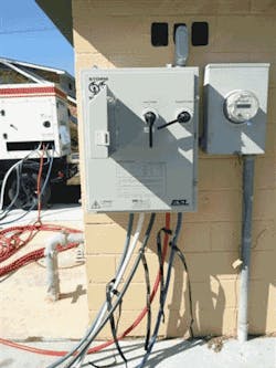

BKI's scope of deliverables for the City of Gretna encompassed significant improvements and upgrades to the electrical infrastructure for the wastewater treatment plant. An important part of the project included replacing one failed permanent generator and installing a second for redundant power at the two primary lift station facilities. A critical design choice was adding ESL Power Systems’ StormSwitch Manual Transfer Switch to 11 sewer lift station pump sites and to the raw water intake location.
According to Mullis, the ESL product provided an ideal off-the-shelf solution while eliminating the added costs for a custom-engineered system. “The StormSwitch unit allows City of Gretna workers to easily add emergency generator backup power to numerous pumping system locations needing different amperages, while at the same time meeting the UL1008 standard with a robust NEMA-3R-rated enclosure and complying with National Electrical Code Art. 702 requirements for optional standby systems,” he said.
