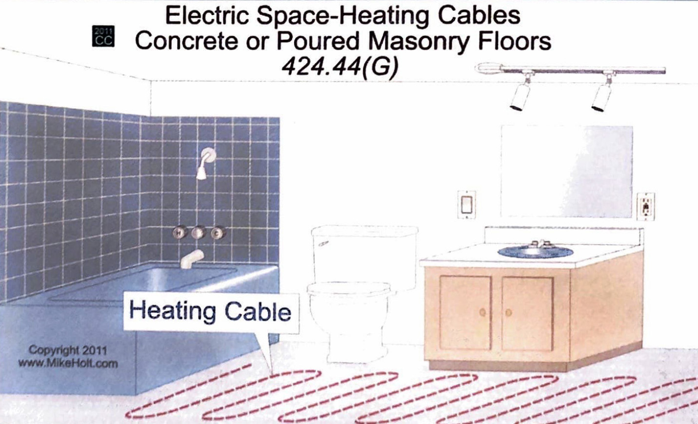

GFCI
The NEC has long required GFCI protection of electric space heating cables that heat floors in bathrooms and hydromassage locations. Now this requirement also includes kitchen floors [424.44(G)], as shown in Fig. 1.

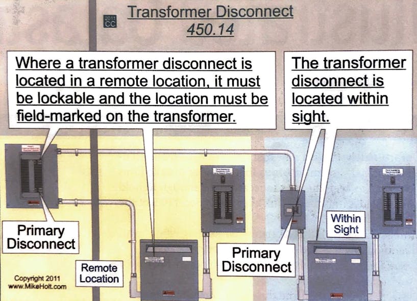

Disconnecting Means
A new section, 450.14, requires a disconnecting means for most transformers. In previous NEC editions, transformers didn’t require a disconnecting means. Although there were no documented injuries to warrant this change, it’s obvious that this requirement should enhance safety.
For transformers other than Class 2 and Class 3, you must provide a means to disconnect all transformer ungrounded primary conductors. The disconnecting means must be within sight of the transformer unless the location of the disconnect is field-marked on the transformer, and the disconnect is lockable (Fig. 3).
Disconnecting
We just ran through an overview of changes to eight NEC articles. We were able to do that in so little space because the changes weren’t extensive. Did you notice a recurring theme here? The 2011 NEC requires disconnects where previously they weren’t required.
