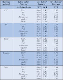

    Calculating the pulling tension
    Now that you've checked most of the factors that affect cable pulling, it's time to start calculating the pulling tension, using the following equation:
    T = L x w x f x W
    where T is the total pulling tension (lb), L is the length (ft) of cable feeder you're pulling, w is the total weight (lb/ft) of the conductors, f is the coefficient of friction (usually 0.5 for well-lubricated conditions), and W is the weight correction factor. (See Table 3 for coefficients of friction of various raceway/cable configurations.)
    Assuming you're pulling from Point A to Point H, you should begin the calculation in incremental parts. Refer to Table 4 for bend multiplier values.
    Step 1: TA-B = 10 ft x 6.6 lb/ft x 0.5 x 1.28
    TA-B = 42 lb
    Step 2: TA-C = TA-B 90° bend multiplier
    TA-C = 42 lb x 2.2
    TA-C = 92 lb
    Step 3: TC-D = 75 ft x 6.6 lb/ft x 0.5 x 1.28
    TC-D = 317 lb
    Step 4: TA-D = TA-C + TC-D
    TA-D = 92 lb + 317 lb
    TA-D = 409 lb
    Step 5: TA-E = TA-D x 90° bend multiplier
    TA-E = 409 lb x 2.2
    TA-E = 900 lb
    Step 6: TE-F = 635 ft x 6.6 lb/ft x 0.5 x 1.28
    TE-F = 2,682 lb
    Step 7: TA-F = TA-E + TE-F
    TA-F = 900 lb + 2,682 lb
    TA-F = 3,582 lb
    Step 8: TA-G = TA-F x 90° bend multiplier
    TA-G = 3,582 lb x 2.2
    TA-G = 7,880 lb
    Step 9: TG-H = 30 ft x 6.6 lb/ft x 0.5 x 1.28
    TG-H = 127 lb
    Step 10: TA-H = 7,880 lb + 127 lb
    TA-H = 8,007 lb
    Based on the proper calculations, you'll need approximately 8,000 lb of pulling tension to pull the 15kV conductors, but you're not done yet.
