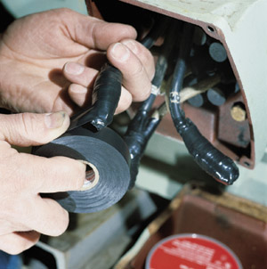

When properly applied, quality tapes can serve as valuable standby resources for jobs such as insulating motor lead connections, inline splices, and split bolt and bus bar connections. Let's take a look at some guidelines for each.
Motor lead insulation. In the case of low-voltage motor lead connections, the tape insulating process consists of connecting feeder cables to motor leads and arranging the conductors for easy wrapping. You should begin by wrapping two layers of varnished cambric tape, which is available with or without adhesive. For the adhesive type, apply with the adhesive side out for clean re-entry.
Follow up this first step by wrapping four half-lapped layers of rubber insulating tape over the cambric tape, which creates a moisture barrier and provides the primary insulation in the connection. Finally, over-wrap the assembly with a minimum of two half-lapped layers of vinyl electrical tape. This should extend approximately two tape widths beyond the ends of the rubber tape. Stretch this tape as you wrap it so you get good conformance to the underlying structure. This also helps complete the moisture seal.
Inline splice insulation. You can protect a low-voltage inline splice in a similar manner by wrapping the installed connector with four half-lapped layers of rubber mastic tape or rubber splicing tape, and then over-wrapping it with two half-lapped layers of premium vinyl electrical tape.
Split bolt connection. Protection of a split bolt connection begins with installing the connector and wrapping it with two layers of varnished cambric tape. Next, wrap the splice with four half-lapped layers of rubber or rubber mastic tape. Complete the job by over-wrapping with at least two half-lapped layers of premium vinyl electrical tape.
Bus bar. A common method of insulating a bus bar connection is to first wrap it with two layers of varnished cambric. The subsequent steps consist of four half-lapped layers of rubber or rubber mastic followed by two half-lapped layers of premium vinyl tape.
