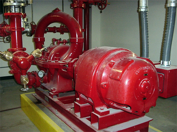

    According to the scope statement of Art. 695, it covers the installation of the fire pump supply and controls. It doesn’t cover the jockey pumps or the internal wiring of the system (Photo).
    The rules covering the installation of electric power sources and interconnecting circuits for switching and control equipment dedicated to fire pump drivers are very specific.
