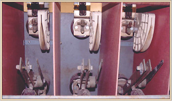

The subject load circuit interrupter is a 3-phase, 3-pole, 4,160V, 600A device capable of interrupting the full 600A of rated current. The device is manually operated with a handle on a spring-loaded mechanism. Each of the three poles of the device consists of two movable contacts or blades: a main contact, or main switch blade, and an interrupting contact, or flicker blade (Photo 1). In the closed position the main switch blade fits tightly around a stationary primary contact and the flicker blade slides into the arc chute to fit between spring-loaded pieces of metal that form the stationary arcing contact. The flicker blade is mounted to the main blade with a loaded spring on the hub or point of rotation. Under normal operating conditions, the main contact carries the load current. The flicker blade is used to facilitate the rapid opening of the circuit to minimize arcing.
When the switch is in the closed (“on”) position, the handle is intended to be nearly vertical pointing up (Photo 2 here). When it's pulled down the main spring is compressed. However, the blades don't move during the first approximately 90° of handle rotation. After the first 90° of handle rotation, the mechanical coupling engages to force the main switch blades to move from the closed position, and the force of the main spring is applied to drive the contacts open while friction in the arc chute restrains the interrupting contacts from moving (Photo 3 here). The momentum of the rotating main switch blades under the force of the main spring and a charged spring at the base of the flicker blade then pulls the flicker blade free of the arc chute. Because the flicker blade is driven with a spring, it moves at a consistently high speed, minimizing the duration and destructive effect of arcing. Photo 4 (here) illustrates the fully open position of the handle and contacts. Note that a hole is provided in the handle mechanism through which maintenance personnel may insert a padlock to secure the switch against accidental closing during maintenance procedures.

After the accident, inspectors found that the flicker blade of at least one of the poles was engaged in the arc chute, despite the fact the handle was in the open position and locked with a padlock. I observed a similar intermittent malfunction in two of the load circuit interrupters not associated with the accident that I tested. Sometimes, when the handle was moved from the closed position to the open position, one or more of the interrupting contacts were left in the arc chute although the main contacts were opened, as illustrated in Photo 5.
The failure mode occurs in some circumstances that may vary with temperature, humidity, dust accumulation, and other factors when the frictional force between the arcing contact and arc chute exceeds the opening force of the interrupting contact spring and the opening force of the main spring. Thus, when the operator-applied force is stopped by the limit of travel in the handle, motion of the main switch blade is arrested, leaving the contacts in the position shown in Photo 5. At this point, the spring on the flicker blade isn't sufficiently strong to break it free of the arc chute, leaving the arcing contact engaged and energized, despite the fully open position of the handle. So the device could be locked open even with one or more of the flicker blades still engaged, showing that the primary cause of the accident was a faulty design in the load circuit interrupter.

The load circuit interrupter is provided with a window to allow an individual to directly examine the contacts to verify that they're all fully separated. Dust on the window or lighting conditions may have obscured the electrician's view of the contacts, or the electrician may have looked in and seen at least one contact opened and assumed that all three were open. Nevertheless, if he had deliberately examined each pole of the load circuit interrupter, he would have noticed that at least one of the flicker blades hadn't cleared the chute. In this situation, simply testing for the presence of voltage wasn't adequate to verify proper operation of the interrupter. He should have repeated the test for the presence of voltage when he resumed work after a 3-week interval.
